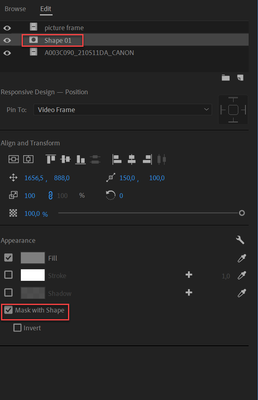

The shape is the same size as the picture frame.
Assets can be animated separately.

A bit more of an explanation would be helpful in understanding what I'm seeing over here.
LEGEND ,
Dec 25, 2022 Dec 25, 2022
Ok ... look at the order of the layer stack in the EGP Edit tab's top panel ... the picture frame, the shape, and the image top to bottom.
Top covers bottom, just like having a clip on V2 blocks the clip on V1 ... unless there's opacity or some other effect, right?
So the picture frame will completely show always.
Below that is that shape, made and positioned to fill precisely to the inner edges of the frame. It's just made by adding a New/Rectangle in that panel, then setting size & position.
Then ... note the red highlight around the "mask with shape" option. This makes the shape a mask, rather than a visible object.
Below that is the image that fills that shape as mask. And you can size, position, even animate that layer of the stack of course.
With this setup, you can then even select all three in the layer stack, "Group" ... and they can then be moved as a single unit.
