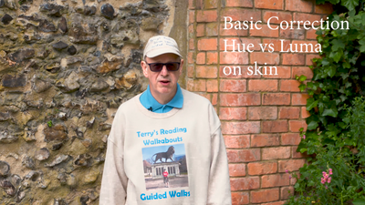

The latest Premiere looks very good!  However I watched a vid on how to use "Hue vs Luma" (on Resolve) and tried to use that technique on Premiere. It did much the same thing but upon Render the result was unuseable 😞

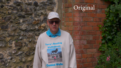

Attached 3 frames, still 1 is from the original. Still 2 has basic correction (up exposure) and still 3 has an additional hue vs Luma. There is only one Lumetri control. On Still 3 you can see some blocking effects - not on the area I wanted to add Luma to. Of course these are "live" when you play the H.264 rendered clip.

thanks for the tps. It is possible to see squares and bands on Terry'd sleeve but it looks worse on a movie.
What I was trying to do is raise the brightness just on his face - the cap lid acts as a sunshade.
I'm going to try to upload another clip. On this one you can still see some artefacts on his shirt but if you look at the gravel path on bottom right it looks "alive".

That looks like you've got just a bit of video noise and making that Luma adjustment made it more notable. This is a regular part of color work, and why colorists know their noise reduction software (typically Neat 5 at th moment) so well.
Lifting almost anything does have the probability of making any noise there more visible. And getting banding. Inducing blocking artifacts.
There are several strategies to reduce this problem ... first option for this situation, use masking. You can go into the ECP, and there's a mask option as part of the Lumetri effect. Set a mask around the guy's face but excluding the walkway and his shirt. That way you're only lifting his face.
And the strategy about using multiple tools is still applicable.
And ... Neat is your friend. Um ... hope you've got a decent CPU/GPU there ... sigh.
