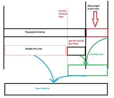

Engaged ,
Sep 02, 2025 Sep 02, 2025
In may case it is inserts that are at the end of a timeline
So I wonder if PPRO can only copy a croped version of the timeline , do its work then recoup the cut content with added content in an "addition" way.

Engaged ,
And if you missed my second message this is full image of my suggestion (assuming the disabled area when used to recoup the new timeline would not consume as much as the copy it does when an insert happens otherwise it would be as slow and would not work):
