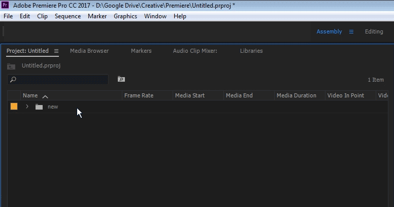

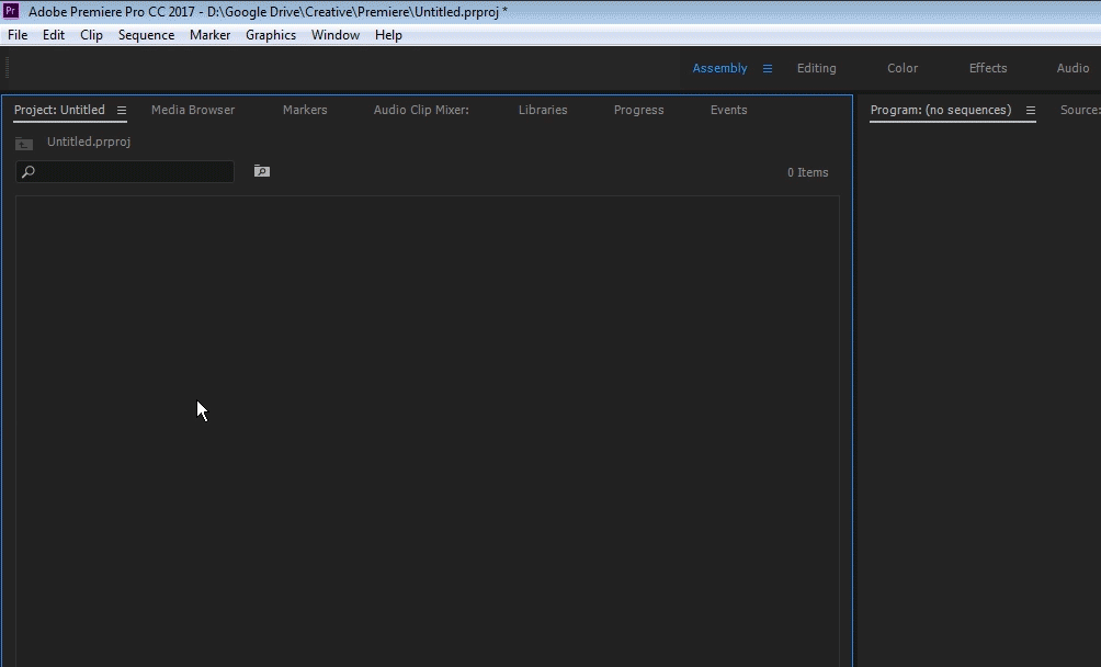

also works when the bin is not float:

I'm seeing a pattern here... can you try this? ...
1. Open Premiere/Project etc.
2. Change Project Panel view to "list view" mode (non-icon view).... click button in lower/left to change modes.
3. Create a new bin named BinAAA or whatever.
4. Double-click in BinAAA.
5. After it opens, double-click in BinAAA's client area (the area which is blank)... that prompts for import.
6. Select a movie file and Open/OK to import.
7. You should see it go in the parent... if you don't, try the following...
8. Ensure that no bin is selected in the project panel... i.e., click in a blank area of the project panel (i.e., no bin should be highlighted selected). Do this after the above steps ... so BinAAA is floating and empty and ready.
9. Double-click in client area of BinAAA and choose file and click Open/OK to import. It should go in the parent assuming there isn't yet another variable here.
Interestingly I also notice...
1. Create a BinBBB the same as BinAAA above.... both BinAAA and BinBBB should be floating.
2. Select/highlight BinAAA in the Project panel.
3. Double-click in the client (blank) area of BinBBB to import, select file, click Open/OK to complete import, it will be imported to BinAAA, the last bin selected in the project panel.
If you still don't see it, there's a missing variable here. But I noticed it was touchy based on what is currently selected in the project panel and while I see the oddity with icon view, it seems list view makes it easier for me to deselect everything and easier to reproduce. I'm not certain something in my configuration isn't causing it but I did remove and reinstall without keeping prefs.

I see now.
there's a problem with your step #5 - "double clicking the blank area to import" - it does not import the files into the bin, but instead just below it. did this ever work for you?  I checked in 2015.3 and it's the same behavior as CC2017. not sure this was ever a feature.
I got a workflow that might work for you, this is what I do in Ae: just highlight the bin (click on the folder once) and press Ctrl+I to import your files...

I can't reproduce this double click issue.
if I double click the folder, there will be a float box and import works fine to the bin if I click twice in the blank space or Ctrl+I.
if I double click the blank space on the bin layer (not the folder icon, just the same line), it's the same as clicking a blank space in the whole project panel i.e the files won't be in any bin and this works the same in 2015.4
as for right clicking the folder (as it highlights the Bin line) and choosing import, or highlighting the folder and clicking Ctrl+I, the files are imported into the bin.
