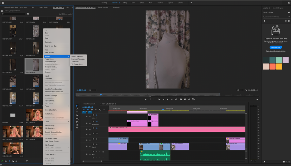

Emma, try to highlight all the original clips on the Project panel, then interpret them into the correct display of colors on the timeline, as in the screenshot

First, highlight your main original clips, then as in the screenshot
I'm using win 11. On the iMac, look on the top panel
