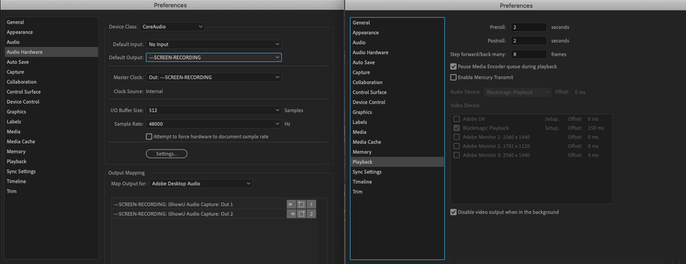

What is Output: screen recording?
Participant ,
Dec 03, 2020 Dec 03, 2020
Hi, Ann.  "Uutput screen recording" is basically an "aggregate audio device" which enables be to caputre system audio when screen recording as well as my USB mic using the Audio MIDI setup utility on the mac, as well as an app called iShowU Audio Capture. (Screen recordings via Quicktime fail to record audio without doing this, even if you have it set to record system audio).
For the record, it doesn't have any affect on my playback responsiveness (as I've tested with this both on and off)... and since the problem existed before I created this setup.  I'd always had it set to "external headphones" and the problem existed then, too.

Hi, Kevin.  Thanks for the response.  Will do, but could you please clarify what you mean by "without any audio hardware connected"?  I did a test where I set output to my MBP speakers and this did not help.  You mentioned "Control Surfaces" though???  I do have a TangentWave connected but that should have nothing to do with Audio Hardware, I imagine?internalSpeakers.png

I am not sure why you posted a screen shot that has nothing to do with the settings that need to be setup correctly for good realtime playback performance. The video below may or may not be helpful.

Well Andy, I guess I had given screengrabs that related to my I/O device... which seems to be the problem since when I don't have "mercury transmit" enabled, everything runs snappily.   Premiere does not lag unless I'm monitoring with my external reference monitor.   I feel that the rest of my settings should be optimized for my system, as far as I understand.Prefs2.png
