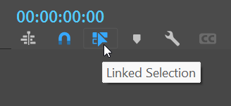

Might have turned off Linked Selection.

Wow! That's the correct answer.
I thought that icon did the same thing as the Link option in the drop down did!
Seems kind of counter intuitive. Thanks!
