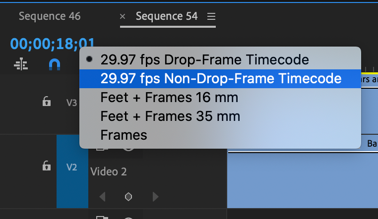

In the timeline, right click on the counter display and choose timecode from the drop down menu:

Problem is that what you suggest is just what can't be done! I right click but I get no otions, just "frames". The same with corresponding counter display in the program monitor. I've just uninstalled the program through Creative Cloud, restarted my computer and then re-installed the program, but sadly enough that did no good. So, what do I do now??

If you right click on the blue numbers, are you offered any choice?

Right-clicking on the blue numbers reveals a grey area, as in your picture above, but instead of different choices there is only one: "Frames".

If your sequence is 15 fps or less it will only display frames.

The source is scanned 8mm film so the sequence is set to 16 fps. I have done several similar projects earlier and always use the same settings. I've just checked that I haven't made any misstake there.
