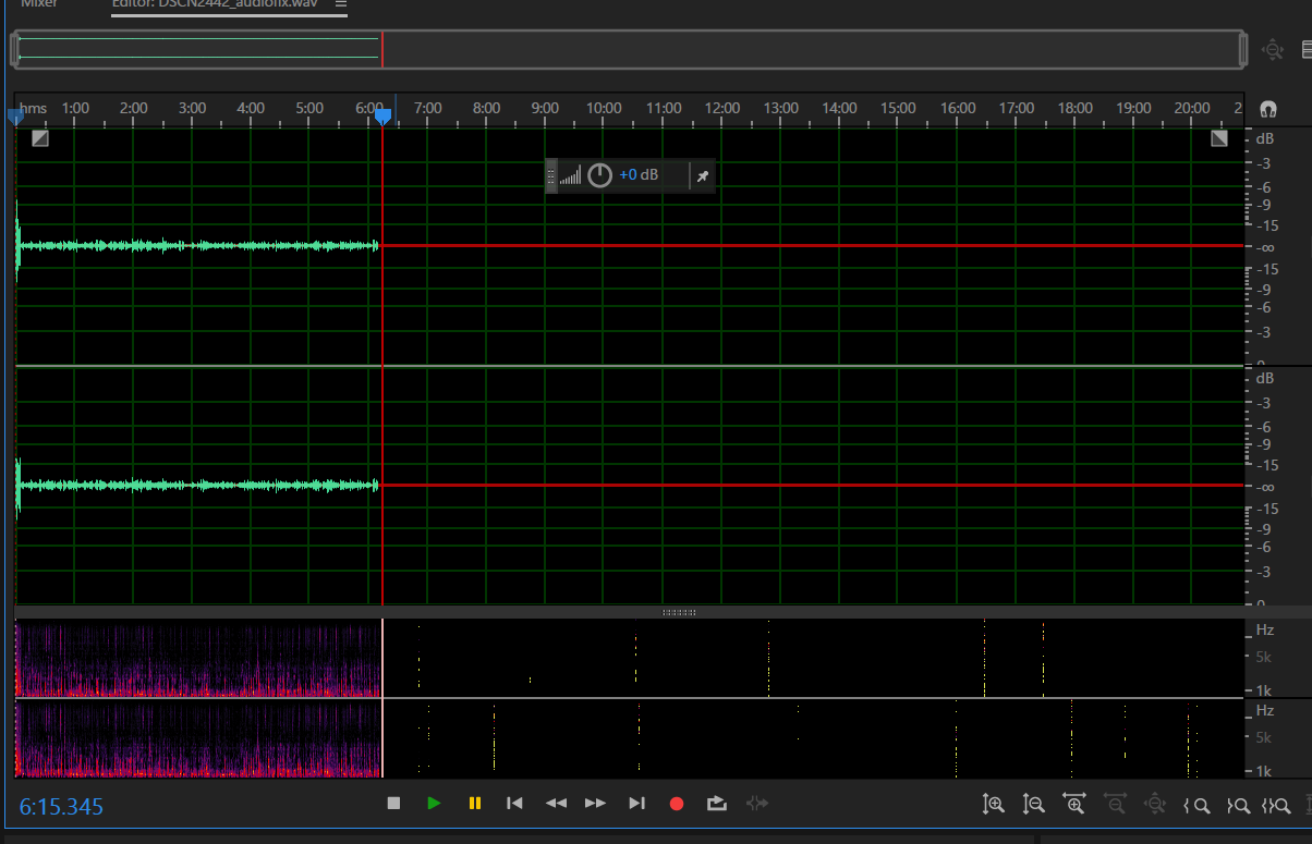

Ah now I'm second guessing what happened. I transferred the audio to Mac (from PC). I swear it was fine until today so maybe it's not Audition. I'm going to start over and do the same noise reduction. But opening the corrupted audio, using Audition for a visual, looks like this; the noise starts at the 6:10 mark. It's like 20 minutes long. I can't find the Audition file I saved now. Sorry but thank you for your time, I'll see if it's fine from here on out.audio drop.PNG
