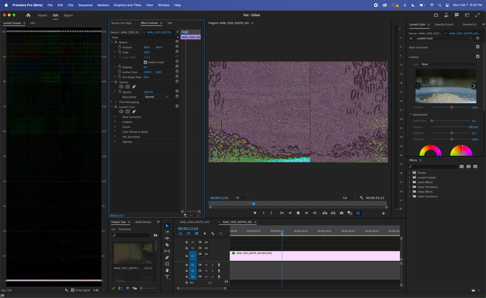

Hi. I just started working on a new Macbook Pro (M1 Pro 2021) and the first export I did with my normal workflow had a lot of yellow glitchy frames (I attached a screenshot) and some graphics disappeared randomly on the video. I have tried with different formats and codecs but I still have the same problem. However, the same project is exported smoothly by my Intel-based iMac. Is anyone experiencing the same problem, has anyone found a way around it?
Thanks.
Javi.
Try turning off Hardware encoding in the Video tab of the export settings.

Hey, thanks for answering. Yes, I have the latest premiere pro version, and this time I'm not working with Raw footage, I'm working with stock videos also in H.264, and I've been trying to export it with these settings H.264 > Match Sequence - High Bitrate.
Copy link to clipboard
Copied
Hey, this worked, Peru Bob! Thank you so much!

I cant export nothing. Playback an export have the same issues. I tried export mp4, Prores, H264 and H265 with all kind of resolutions with effects (lumeti) off and on. It happend in 2 types of projects. I am working with raw komodo footage. I have this problem for about 2 weeks. Using Premiere latest version and I tried with Beta version too.

Turning off hardware encoding did not work for me.
I am having similar problems exporting H.264 clips from media encoder with constant bit rate and variable bit rate - the sectiosn that seem to be causing the most glitches are nested clips, frame holds, and clips with alpha layers. my system is the new 16in macbook pro with m1 max.

I too am having this same problem. I agree nested clips/mulitclips not flattened, dynamic linked clips and stacked graphics are the cuprit and it's random upon mulitple exports of the same clip. Following this thread for a cure.... please Adobe.

Hi Mayjain, I am still seeing glitches in export (H.264 and H.265) in hardware and software encoding on M1 MBP, Premiere 22.4.

The problem is exporting through Media Encoder, not with Premiere. Before you export, open Creative Cloud and make sure to open Media Encoder using the Intel version. Then you can export cleanly. If you let Premiere open Media Encoder, or if you open the M1 version, it will glitch on export.

I can CONFIRM that opening your project with the Intel version of media encoder AND/OR premiere pro via the creative cloud app will get you a glitch free export.

does not work for me. still glitches
Copied
This does not work for me either. Launching media encoder in M1 or Intel mode makes no difference on my M1 machine. Both have horrible quality H246 exports. The only thing that works for me is encoding on an actual Intel machine.

@mayjain I downloaded the beta and gave it a try. The issue still persists. What's the best way for me to get you the project and footage? It's not something I can share publicly.
