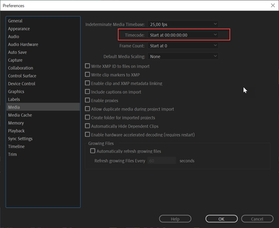

Ann Bens
Oct 31, 2019 6:08 PM UTC
dbeaty2Author
Oct 31, 2019 6:20 PM UTC
Thanks Ann great work around.
