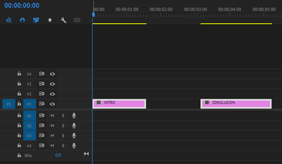

Make a sequence with just the intro and conclusion with blank space in between.
Save the file as VideoTemplate.prproj or something to that effect.
In Finder or Explorer, copy/duplicate that file as many times as you need and name them unique names for each course.
Now when you open each project, you'll have the intro and outro ready to go and you can insert/edit in between.
