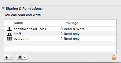

Thanks, I just completed the instructions. I did note however, that next to my user name...how I am logged in, it said read&write but for two other profiles it was read only.

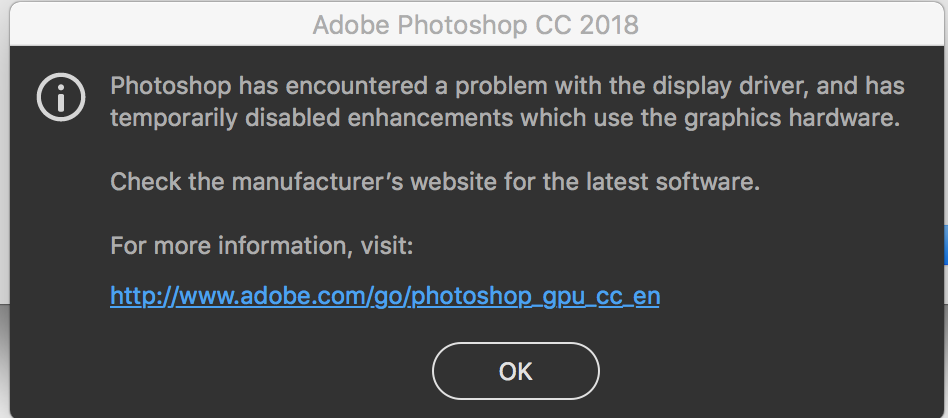

Also after I rebooted I got this Photoshop error.  Photoshop does appear to be working though.
My display card is the NVIDIA GeForce GT 750M 2GB

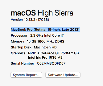

full system specs
