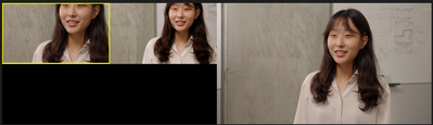

Engaged ,
Mar 11, 2025 Mar 11, 2025
Currently Multi-Camera source angles crop to the resolution of the containing sequence. E.g. a 4K multi-cam placed in a 1080p timeline results in a cropped preview monitor.
Not great for 4K shoots intended for HD delivery where reframing/scaling is needed. It would be great to have the option to disable this behavior so we can view the complete frame.
