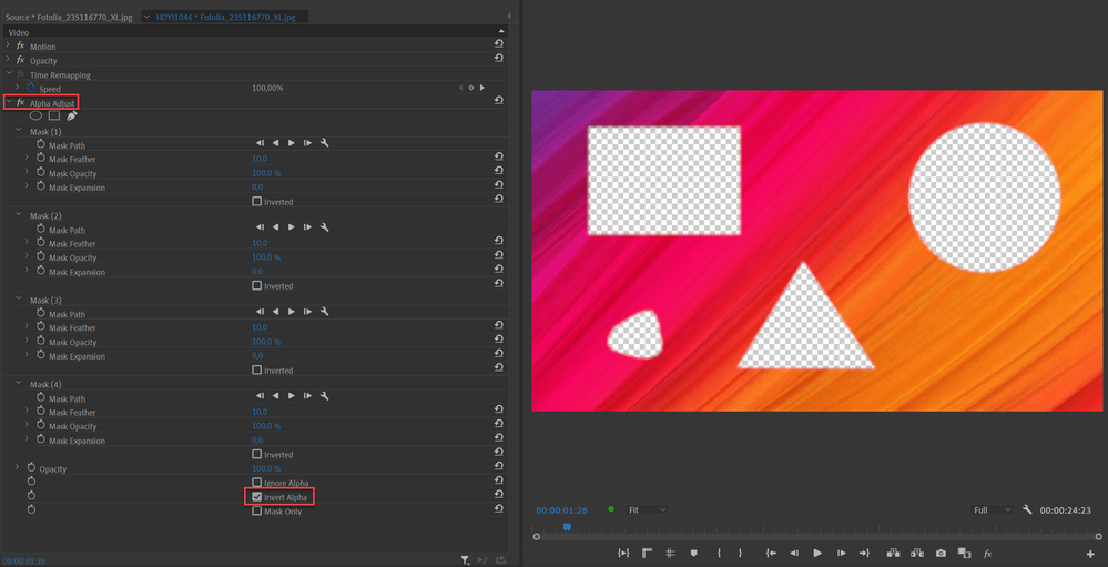

Try this:

Thank you! Thank you for illuminating the fact that you need a separate effect with a different name to do what the opacity adjuster should do already. I'll add this to my mental list of bizarre workarounds needed to make Premiere do what it should do out of the box lol. Seriously you rule.
