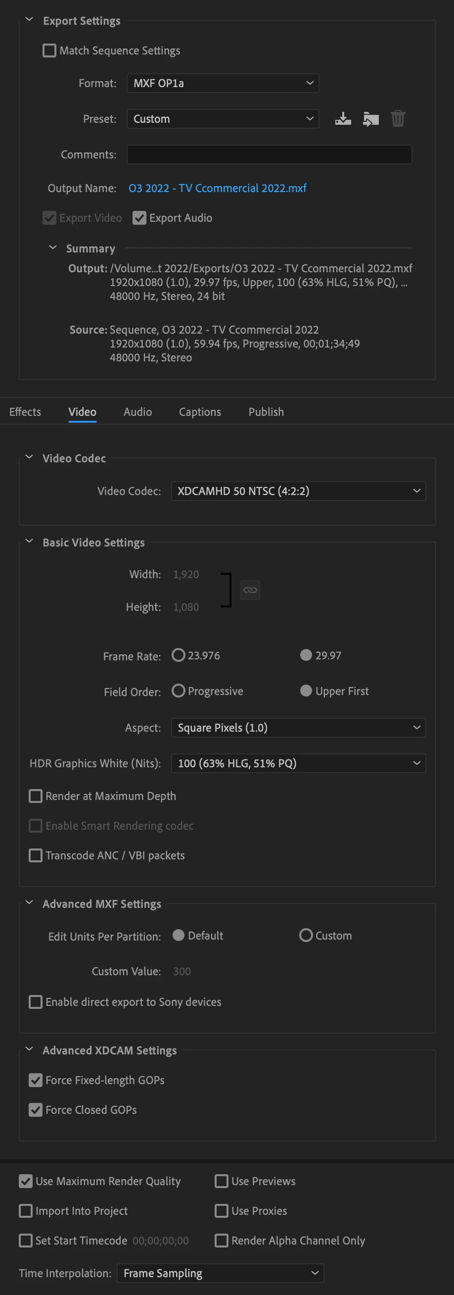

I'm exporting to MXF OP1a XDCAM HD 50 NTSC 60i

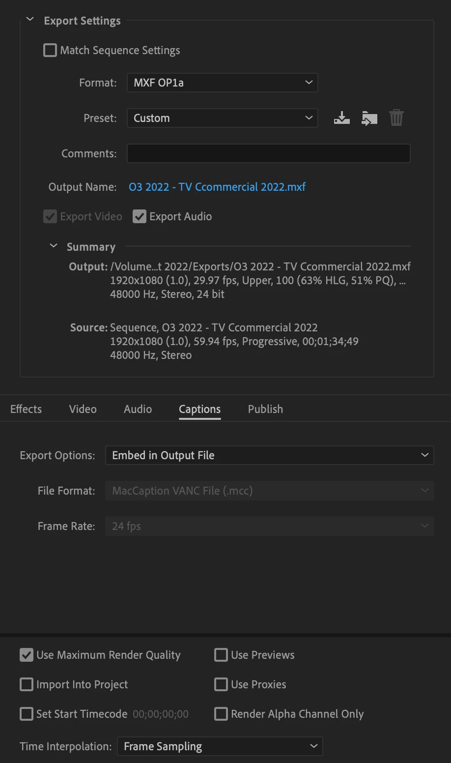

I can successfully output an MXF with embedded 608 captions

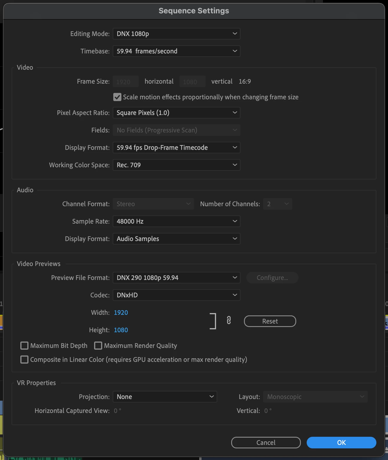

I've attached images of my timeline before export, as well as the exported file re-imported and dropped on the timeline next to the original sequence, my sequence 
settings, and my export settings (video and caption tabs).

The broadcaster has rejected the file becuase of the caption issue, and they also say that there are video breakups throughout. Using Media Encoder to output gives the same result. I've tried all the variations of ticking and unticking Force Fixed-length GOPs and Force Closed GOPs with no improved results.

I'd create a test sequence and simplify the issues. For example, you have a 59.94 sequence going to a 29.97 export. How did you set the caption 1 start time?

Unfortunately, when I set my sequence settings to 29.97 it still cuts off that first caption at the same place. It starts 74 frames after it should.
