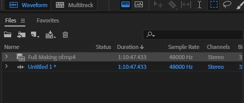

When you use a DAW (I am not on the current version of Audition, as I am not able to install it using Windows 7, but that is a whole different rant for another thread) all you need to do is import the audio from it - you do not need to touch the video at all, and it is probably best not to even try.
When I go to AA2018, I can import the MP4 easily enough even though all I am interested in is the Audio - at this point the video file is irrelevant & can - and should - be ignored as all we are interested in here is the Audio.
Once the video file is imported, you can right-click it in the media browser & extract the audio to a new file, then you can safely remove the original MP4 from the project altogether which will leave you with just the audio to work on, saving a ton of memory resources as shown below:
Right-click after importing
to end up with this
Now you are ready to clean up the audio. Don't use any presets, as these will not do things how they should be, but instead you will need to find the noise issues where they are present, and remove them manually. Personally, I use iZotope RX7 Advanced for this and not audition, but that is just me - although the Sonnox tools are also very, very good for dialogue cleanup as they have modules specifically for this. The AA tools did in the past used to be very good but in all honesty I will need to go take a look at what is on offer in AA2018, which may well not be the same as you have so not too sure what more I can offer here other than to say that YouTube Tutorials are (or will soon be) your new bestie.
If you get stuck with specifics, please post back & we will try to help.
Rendering out the cleaned up audio should be in PCM at 24-bit 48kHz resolution (if you are capturing at 44.1kHz then please change this - all audio for video should be at 48k, and never ever at 44.1 (despite what YouTube will allow) and you need fixed point and not floating point. You can get away with 16-bit but why do this, given that 24-bit is far superior as even if this pads with zeroes on import, the processing will still be carried out in AA internally at 32-bit floating point (set your prefs in AA to use 24-bit fixed with an 8-bit floating, not 16-bit with 16-bit floating) so rendering at 24-bit will give you much better results.
Then import this into Premiere on a stereo track, with your sequence using a stereo master. Align with the original (should be perfect from the get go), right-click the video track & unlink the audio in the original & simply remove it from the project altogether. Now save the Premiere project with a new name, thus leaving your original assets alone at this point onwards.
