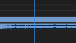

I have opened Premiere Pro today to find all the label colours in my timeline appear to be inverted. The lighter colour is now the main body of the clip and the darker colour is now the waveform. I have tried to go through all the different label group styles. I have also tried uninstalling and reinstalling the application. Does anyone know how to get this back to the default colours.
I have attached an image of what it should look like and what it looks like now.
Correct answer R Neil Haugen
Yea, there's new color stuff available now. And it's puzzling at first.
Go to Preferences/Labels, choose the Classic option lower right.
You still may need to adjust the hue/sat/brightness to taste, just click the color box in that dialog and make changes in the color picker. You do now have a lot of ability to mod that to taste.
To get the green audio back, that's now on the 3-bar menu in the Timeline panel sequence tabs, separating audio and video track color.

Just opened a project to find all of my colors were different just like majority of people here are experiencing. I customized the label preset to Classic and changed the audio color to green. Seems close enough to what it was this last few years for me to be able to go back to work

Go to the Preferences/Labels dialog, lower right select "Classic".
You may need to click on the video track color swatch to bring up the color picker, and set the hue/sat/luma to your wishes.
If you are getting same color on audio and video, go to the Timeline panel, and the Sequence 3-bar menu to the right of any sequence name ... click, and deselect the option for same label for audio/video tracks.
