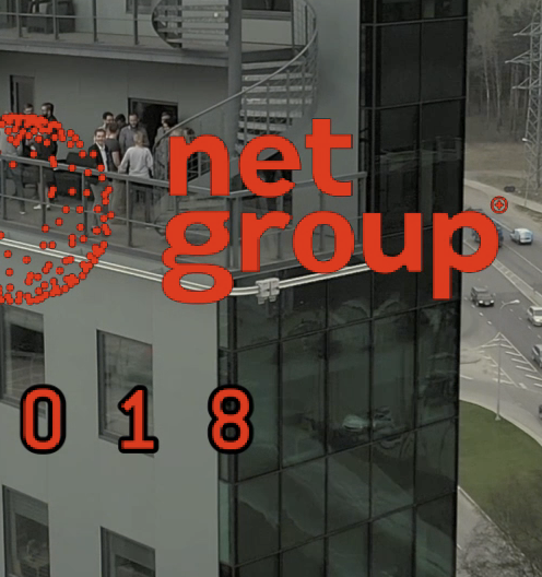

I don't know how would it help, tho there are many previews at the beginning of this thread, but ok, here's the comparing. I also noticed that it's not about H264 codec, because Apple ProRes 422 did the same job.
And it is very easy to replicate. Just add pure red text on darker image or footage and voila. Tried it on another computer as well, just to be sure, it's not machine related. Same same.Red_pixelated.png

Yes, useful indeed. But if the output has no difference if I follow those rules or not, then why bother? We kind a live in a future, and how does it sound for a client that i can't put their red logo on a footage because of a technical limitations. I have to give them good explanation why this is happening.
And also, what color is this logo on the image? I don't think it's 200 16 16

I hope it would help, but it doesn't. As the preview shows there is no difference if red is 255:0:0 or 200:16:16

I wish that would help, but no. 1px stroke on logo and 10px stroke on text. No change. I also tried different reds.

Yes, lets exclude every possible reasons. Both are 1920x1080 and as you look at the black stroke, it's not pixelated. So it's not resolution related. Also, text is just a text inside 1920x1080 precomp.
