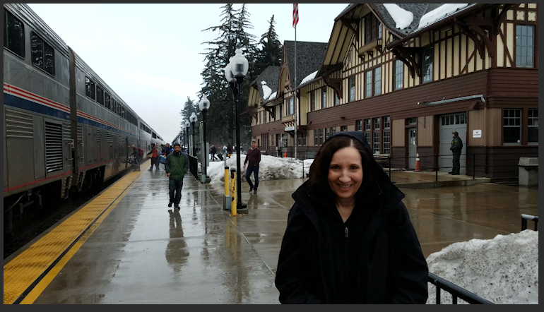

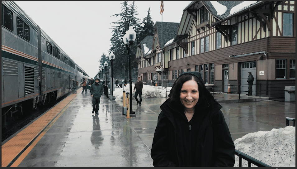

Here's a set of shots ... first, off-camera ... then neutralized (always the first step) ... then with another instance of Lumetri, just using the curves panels, an orange & teal "action movie" or "blockbuster" sort of Look.
I changed a whole bunch of hues with the O&T Look ... and this is fairly mild.

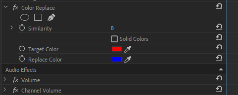

There's also a "Color Replace Effect" in Pr's Effects panel ... type "replace" in the search box, drag/drop onto the clip, you get this in the ECP:
"Target color" eyedropper is used to select the color of the image you want to change, and you can use either the eyedropper to select a color from the image or the box to select any color available to change that target color into.
