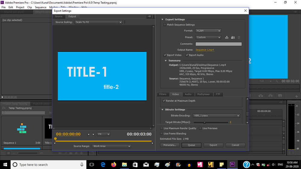

I'm always having low/poor quality output when I export video (in .mp4) from Premiere Pro CS6.
It looks fine & of good quality while editing in PP CS6. It contains an audio, text & an image (.png) as background.
Audio Sample Rate is 44.1khz. Bitrate of the MP3 is 320kbps.
I'm getting Low Quality Video Output even after choosing YouTube 1080 preset followed by render at max depth. Please help me sorting this out! Below are the images of temp video which I made for testing out export settings for my original Music Lyric Video.
Sequence Preset I've usedSequence Preset I've used
Export Settings I selectedExport Settings I selectedLow Quality even after choosing YT 1080 preset followed by render at max depthLow Quality even after choosing YT 1080 preset followed by render at max depth

Im having the same issue. not sure how to fix it.
Nov 01, 2020 Nov 01, 2020
Read the post by Byron Cortez earlier in this thread. You do probably have a mis-match somewhere. That´s what you need to fix.
