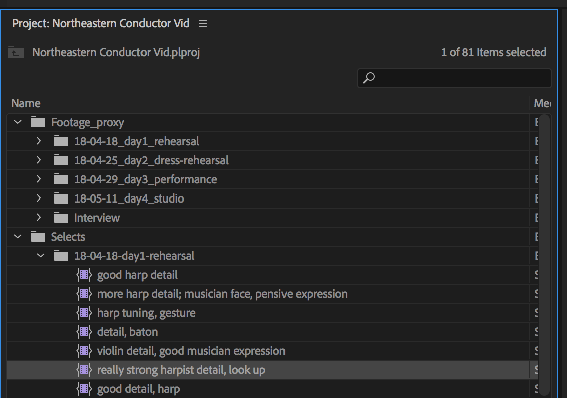

These proxy files I have reviewed and made subclips of in Adobe Prelude (see screenshot). I then sent the Footage_proxy and Selects bins to Premiere and proceeded to *successfully* "Reconnect Full Res Media" for my master files (see second screenshot) but my subclips do not carry over that Full Res Media reconnection. This was the confusing part for me.
Screen Shot 2018-05-24 at 8.22.47 PM.pngScreen Shot 2018-05-24 at 8.23.50 PM.png
I first attempted to just "Reconnect Full Res Media" on the subclips which does connect the media but renames the subclips with the name of the master file defeating the point of me labeling them intelligently for the editing process.
I then did some Googling and found that if I Offline Media the subclip > Relink Media the subclip (to the master file) > Attach Proxy the proxy file I do achieve the desired outcome BUT this only works on one subclip at a time. I have too many subclips to do this for the whole project.
