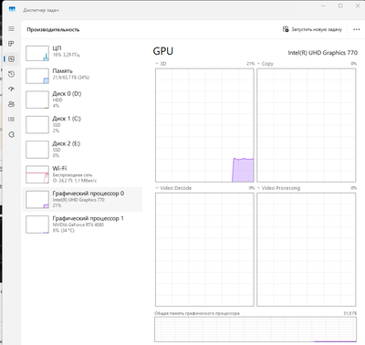

Advocate ,
Dec 05, 2024 Dec 05, 2024
Hi, @mayjain
Your graph shows 3D load, not the decode one. I don't know what 3D shows, but it's not decoding. Still I have them all at 0%. All of the decoding options are on:
I tried turning OpenCL on only, the 3D graph starts showing in the iGPU tab, but as I said it's not Decode. Should I use the Cuda renderer, the iGPU is always at 0%. I tried installing different versions of Intel iGPU drivers as well as Nvidia Studio drivers - of no avail. I Also downgraded my Premiere Pro to v. 24.6 and there it's all OK.
Also take notice of the following. This is the GPU-Z utility showing NO iGPU load at all during the playback of the video and no Video Engine load of the dGPU during the same playback. So none of the videocards are being used for the decoding, but the dGPU is being used for some other processes, I suppose for accelerating the UI.
Where should I dig to?

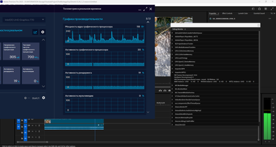

First, here's the decoding data in Premiere Pro's console:
It's a HEVC 10 bit 4:2:0  which is decoded but Premiere Pro shows I have no Intel iGPU installed and the decoding is done by the software, not a hardware decoding. One might think there's a problem with my iGPU, it's dead or something.
But I open Intel's Graphics software and see there that my iGPU not only works, it actually does something when I play back this video in Premiere Pro:
But Windows tells me that my iGPU is silent during this same process - there's something 3D but it's definitelly not the decoding:
SO the only thing I see now since no one has come up with any idea how to fix it by small blood is to reinstall Windows... Though here are two options too - go back to 23h2 and have no ussies though an older Windows version or 24h2 and pray that a second installation will fix this issue...

Do you want to see an interesting thing related to this issue?
This is what I'm seeing right now - still Win 11 24h2, still no decoding in the Windows graph, Premiere Pro showng in its console that I have no iGPU installed at all and there's only Software decoding going on...
The most interesting thing here is - just think! - I'm now having my 4080 turned off (unplugged) and my monitor plugged into the motherboard to work with my iGPU.
Yeah...
