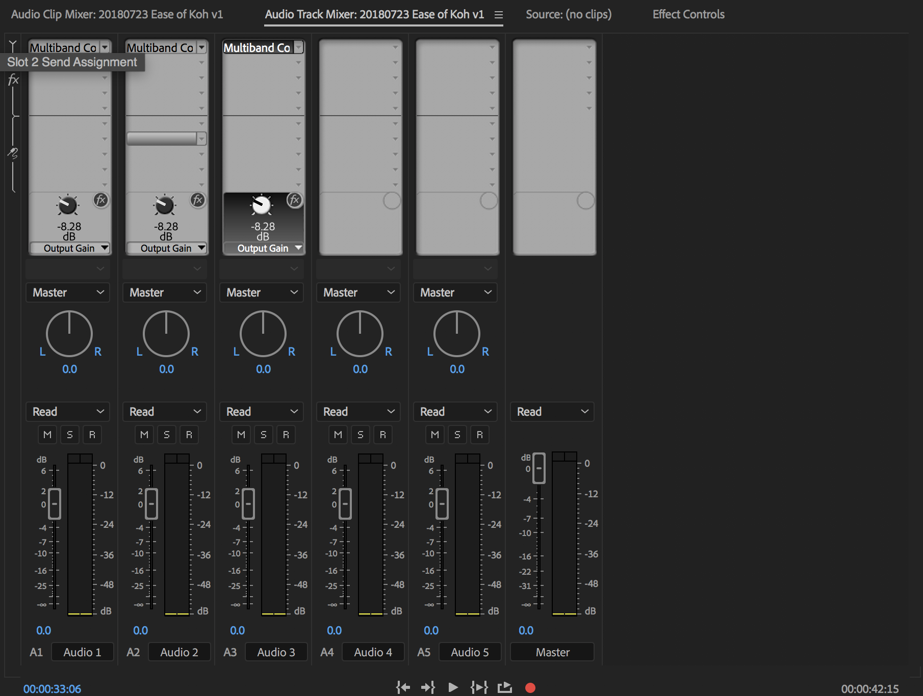

if I have set audio levels to a maximum of -8.28 DBs on the audio clip mixer for a sequence
Just to clarify, there is a Clip Mixer, and a Track Mixer.  These are two different things with different uses and behavior.  The Clip Mixer will not affect the sequence at all, only the active clip.
I wonder if you're confusing the two Mixers?
New Here ,
Jul 30, 2018 Jul 30, 2018
Hi Jim,
It's actually the Track Mixer that I'm referring to:
Peace,
C

Hi Jim,
That doesn't appear to be the same issue - I'm having problems when re-opening old projects, rather than duplicating sequences.
i.e. I have a sequence saved in a project (with certain settings applied to the track mixer) and those settings disappear when I reopen that project and then the sequence within it.
