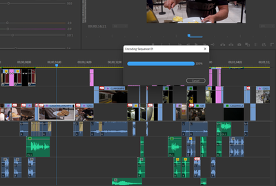

Premiere Pro takes too long on 100% and creates a file _00_
Participant ,
Aug 14, 2022 Aug 14, 2022
it stays on 100% forever. It creates a file with an extension  filename.mp4._00_
and stops rendering. If I press cancel the file is created normally.
This does not seem like a normal behaviour.

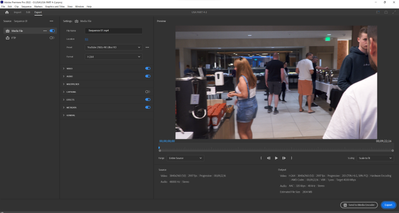

My export settings

If I have to hit CANCEL on 100% and have premiere restarted so the file is created.
Turn off hardware encoding and try cbr.
Also if checked turn off max render and max depth.
