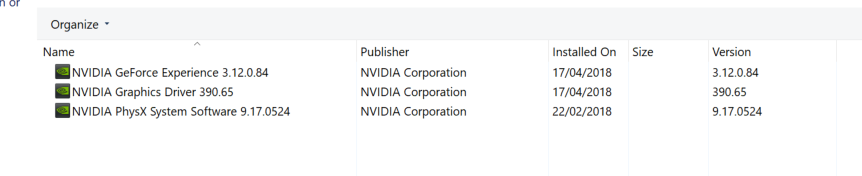

[RESOLVED]
OK I have installed the latest drivers for Nvidia over the default ones that came with the base install. This appears to have resolved the issue for me.
If you have an extra GPU the try disabling it in Device Manager to see if you can open Premiere with that one disabled. If it does open then try downloading the latest drivers for it.
Screenshots of the before and after drivers below.
BEFORE:
AFTER:
I can now open Premiere Pro with no issue, and I can also render. Tried several times with no crash.
Hope this helps.
