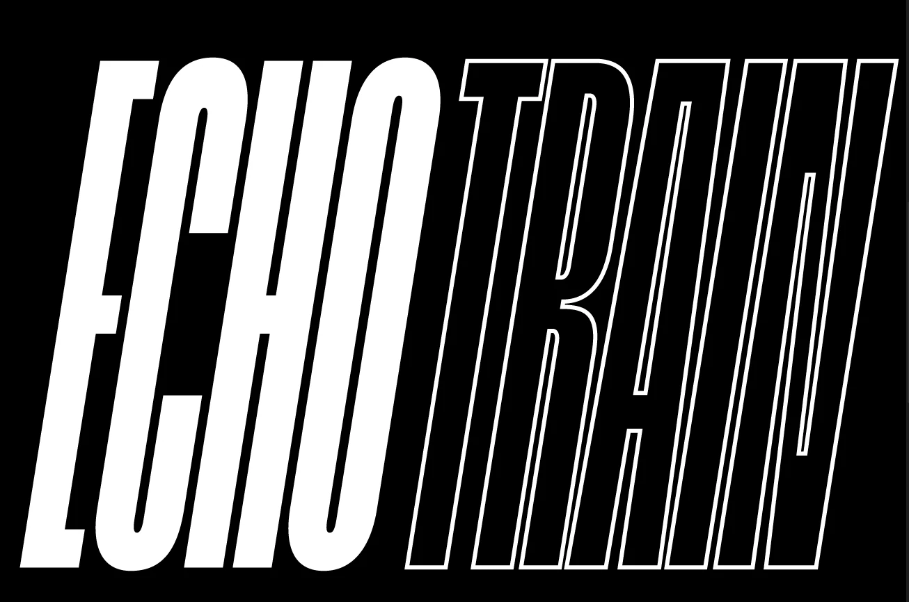

I am pretty new to premiere pro. I am trying to create a very simple sequence that uses 2 still images.
However, when I export the project (and even within the main PP window), I am getting a pixelated/blury result. The source PNG seems to show up fine (maybe a little pixelated) but as soon as I use it in the timeline, things turn ugly.
I am using full playback resolution.
Any help would be greatly appreciated 🙂

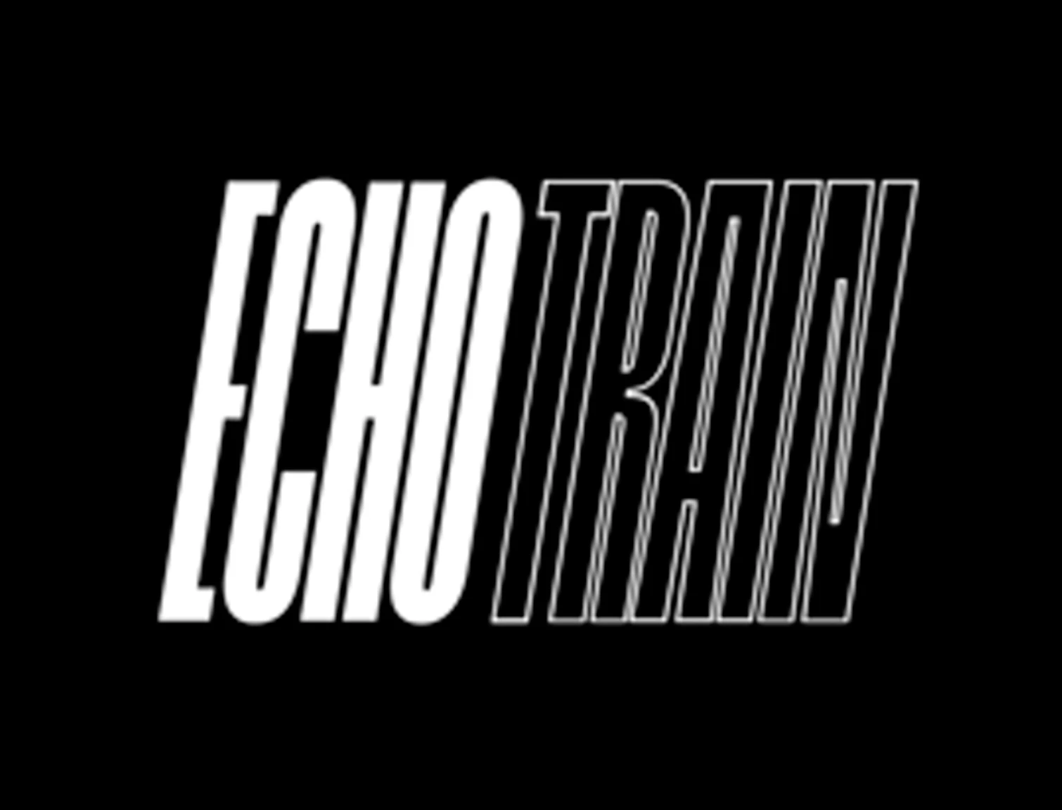

I can tell from your after render example, that the frame size and aspect ratio are different than your PNG, meaning you're likely not using correct sequence and export settings. Use sequence and export settings appropriate for your project and intended delivery. If you're unsure, use a Preset to help get you started, or do a Google search for export settings for your intended delivery (YouTube, Instagram, etc.)
As far as your export, it all comes down to your export settings. In general, many video formats meant for web delivery are heavily compressed (H.264 for example) and depending on your bitrate and export resolution, that will impact the final result.
