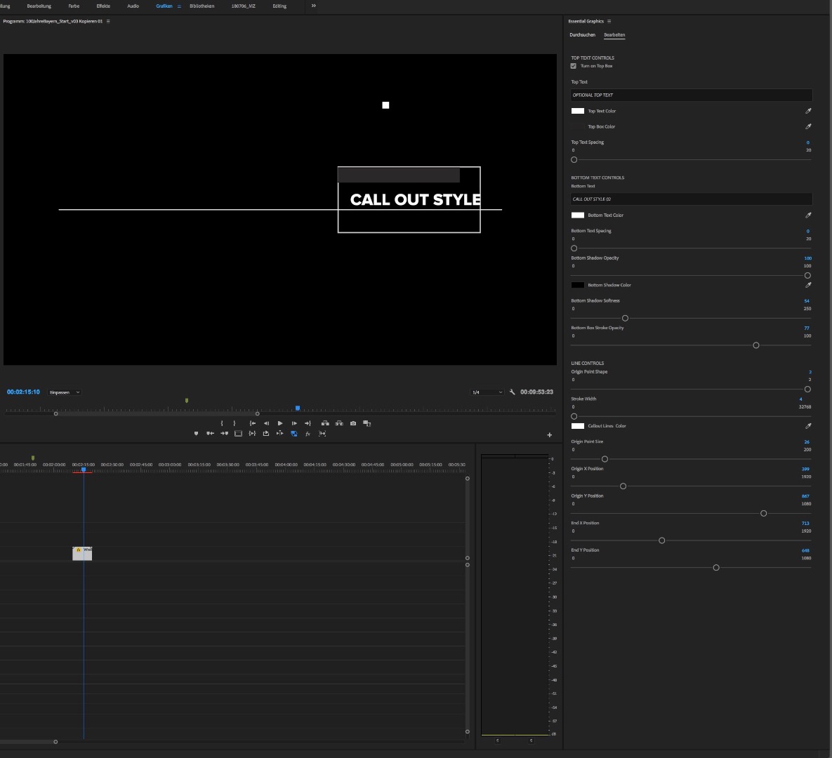

New Here ,
Jul 06, 2018 Jul 06, 2018
LINE CONTROLS
Origin X Position changes the position of the line on the x axis (the starting position)
Origin Y Position changes the line position on the y axis (the starting position)
same for End X and End Y positions (the end position)
New Here ,
Yes, I know, but when I change any of them. nothing happens.
if nothing happens when you work with those properties, this leads me to conclude that
there is something wrong with the expressions or maybe the expressions are not
universalized, it happens sometimes with the creators of mogrts, you have 2 options,
either send a message to the original creator or Adobe Stock, or send it to me so that
I fix it for you, but send it as a pm so that it won't be downloaded by everyone here
if you want additional controls, you have to tell me what you exactly want and send me the mogrt file
if you have a checkbox option, one for the thin line and one for the text, an on/off switch checkbox,
create a duplicate of the mogrt in premiere, one with the box checked and the text unchecked,
another with text checked and box unchecked, and adjust positions and sizes in premiere
effect controls motion..  i really dunno how the mogrt is structured, so that's just as I imagine
it is structured
