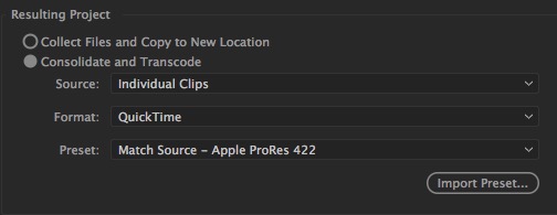

Before when i was done with my project and I wanted to archive my Final project i was using the project manager. I was using the option "exclude unused clips and was using the option "consolidate and transcode" the project. The final result was an organized folder with a reduced project size (sometimes 3 times less than the original size).
Unfortunately for the past few months i have been doing the same thing but the project size rest unchanged! I'm working with 4k files and the original project is around 130 GB. Please see file attached. I would like to know how you guys archive and how to make the final project smaller and removing the clips not used. Please not that i have tried other preset and formats and still nothing. It looks like it doesn't exclude the unused clips.

This is very nice from you to answer. I still don't get it. All my footages are PRORES 422 but when i try to consolidate and transcode via the manager to only use the part of the clip i'm using on my timeline it still copy the full clips. I just want the project manager to copy/trimmed the part of the video i'm using. I'm 99% sure the old premiere version was doing this correctly.

First: What settings are you using for Consolidate and Transcode? Try using the following:
Second: Do any of the bullet points from my other post apply anywhere in your project? For example: have you applied any effects at the master clip level? Do you have any merged or Render and Replace clips? Have you made any Modify - Audio Channel changes?
Any of the above (and more) can result in the full clip copying and not trimming. Try the above settings and see if that works. If not, duplicate a sequence and try to trim it down to the bare minimum and see if that will Consolidate and Transcode correctly.

thanks! I did apply some lumetri colors on the master clips. I just did a quick test and it looks like it is exactly the problem! I can't believe it you saved me so much time and $. Do i just need to apply the LC on each clips used?

Yes, if you apply the same Lumetri effect on each clip (instead of the master) you'll get the same color result and your consolidate and transcode will work.
