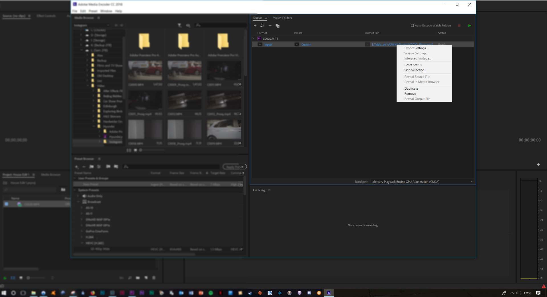

I can get up to the step just before you modify the frame rate of the source footage.
For me, there is no option to modify the highlighted clip in media encoder...
Is there something I'm doing wrong? or is there a way top get around this?
I'm trying to proxy footage from an A7iii shot at 120 fps (119.88 to be specific), but every time I've tried using the automatic ingest process, the proxies have come out at 60 fps and playback has been two times faster than it should be...
Any help would be massively appreciated.
Thanks

Hi Sam,
I believe the fix is pretty easy. It looks like you're clicking on the output file rather than the input. Try clicking on the C0020.mp4 and selecting Interpret Footage there... that hopefully will do the trick for you.
I too have the A7III and so far I'm liking it. Just learned yesterday that you can use "Gamma Assist" to preview SLOG-2 in regular Rec709 to get a better idea of final image, which I'm really excited to try.
Let us know if that interpret lets you get your 120fps down to the 30 or 24 you're after. I haven't tried it from 120 yet.
Good luck,
Barrett
