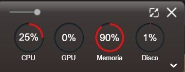

Hi, I use an MSI GE73 Raider with I7 processor, 16GB RAM and a NVIDIA GTX1060.
With Premiere Pro & Media Encoder 14.9 GPU is not used in rendering also if HW encoding is selected and "Nvidia Codec" appears on encoding window...
The rendering time is intolerable... I have a second machine with an AMD RX580, that in the past was  less efficent than machine with nvidia card, but now, for the same video the AMD Codec use 100% of GPU and 20% of CPU and Nvidia Codec 0% of GPU and 30% of CPU (see attachment) and the rendering time is comparable as "only software" option... 😞
I performed a clean uninstall with DDU 18.xxx in safe mode, and reinstalled lastest NVidia Studio Drivers but nothing chenged... 😞
I noticed that debug console (xxxx) shown different options for the 2 different machines (I think is normal because of different hardware is recognized, but i posta slo this detail if it can help...)
Please Help me... The Adobe Support is useless... after 2 days in various chat no solution are proposed from Adobe...

CUDA Render is enable, recognized and used, on the various windows but GPU is 0% (max 10% peak for instants).
The timeline render bar is obviously red in some zones but the project is the same in 2 differnt machines with a big render time differnce... and use of 100% of AMD GPU...
