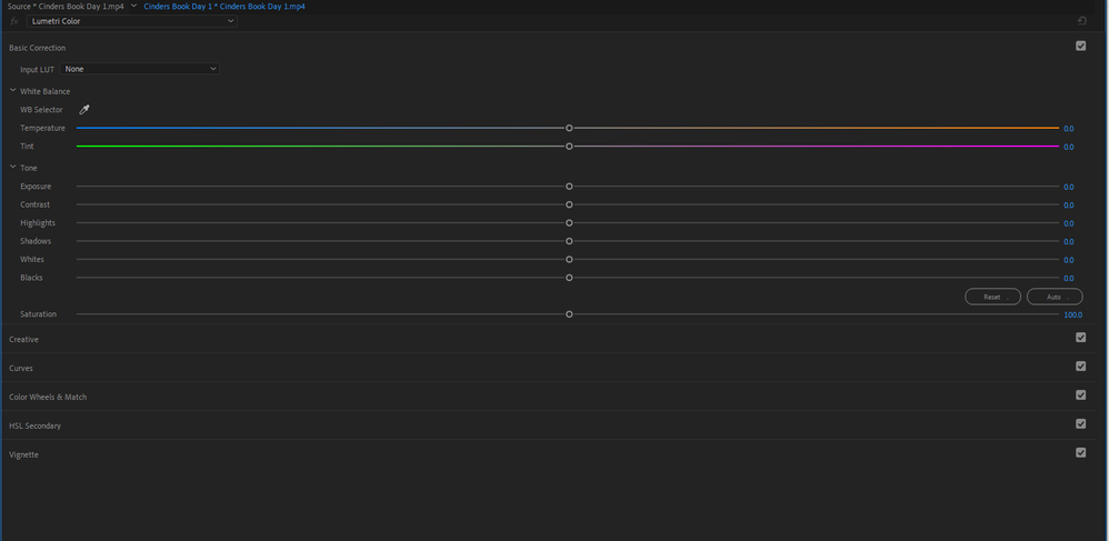

It's very hard to see from your screen shot what is wrong, try using the Lumetri colour correction panel to alter contrast, exposure, white and black levels.
