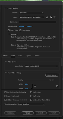

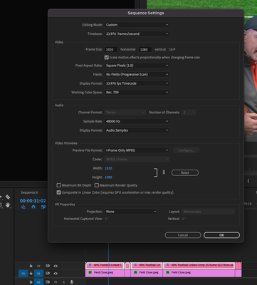

Here are some screenshots. Thanks

In addition, what is the actual resolution of your original (not re-converted) source video? If your original was really 4096x2160, you might have downscaled your video in After Effects to 1920x1080, and then when you imported that After Effects composition into Premiere Pro, the timeline got set automatically to that lower resolution, and then you tried to export that as 4096x2160. Well, what you actually did was perform an image-degrading double conversion, which astronomically increased the rendering time while degrading or even ruining the image quality at the same time.

Simple. Your export settings are set to 4096x2160, and it takes much, much longer to export to that resolution than it does to 1920x1080. And by default Adobe will upscale that 1920x1080 image to a 4096x2160 image, leaving small black borders at the left and right edges of the frame. All that takes even more time.
Unfortunely, there is no good way to export a 1080p image as 4k without all that processing, unless you intend to have a very small windowed image within the larger frame. To eliminate most of that processing, set the export resolution to 1920x1080, and then check back.

You responded before I edited my post. You have to make sure that both the project resolution and the export resolution are exactly the same (in this case, 1920x1080). Otherwise, Adobe Premiere will automatically re-scale the video by default, increasing the rendering time substantially.

From what I can see is that in your Export Settings, you have chosen the Adobe Stock 4K DCI preset. Why is that, considering that your source material is 1080p?
