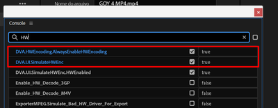

When I clear the preferences and everything else, the Performance (Desempenho) changes back to "Software". As you can see in the following image:
And when this happens, I open the Debug Console and Activate these following options to be able to choose "Hardware Encoding" (Acelerado por hardware):
I don't know what's happen when I start to render, because it appears that it changes back in the background to "Software" to take so long, since it doesn't make any sense to take so long to render even using GPU. And when I do render, I just let Premiere open alone, no other program along with it.
