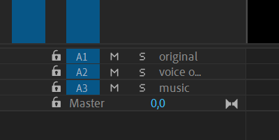

I agree this would be a nice feature,    You can name tracks, but they only display if the track height is sufficient.   use the expand all tracks command with the timeline active and then control click on the right side of the track patch panel and you'll see the rename option.  I don't think either one of us understand the complexities of programming involved in adding and or modifying a feature so don't get your hopes up...  but a quick search of this forum for "feature requests" turns up this link

If you customize the track you can have exactly what you want.
Right click on the trackheader: customize and drag the icon where you want them. Track name is V1 or A1.

brilliant! - it's a bit buggy, but it works - if we now could have track colors we are completely happy, and the ex-avid editors stop nagging 🙂

how this work actually? i opened up button editor but unable to drag the track name to above level. everything inside the button editor are not moveable.

oh, i found it, it is drag to the timeline. finally can see the name, thanks
