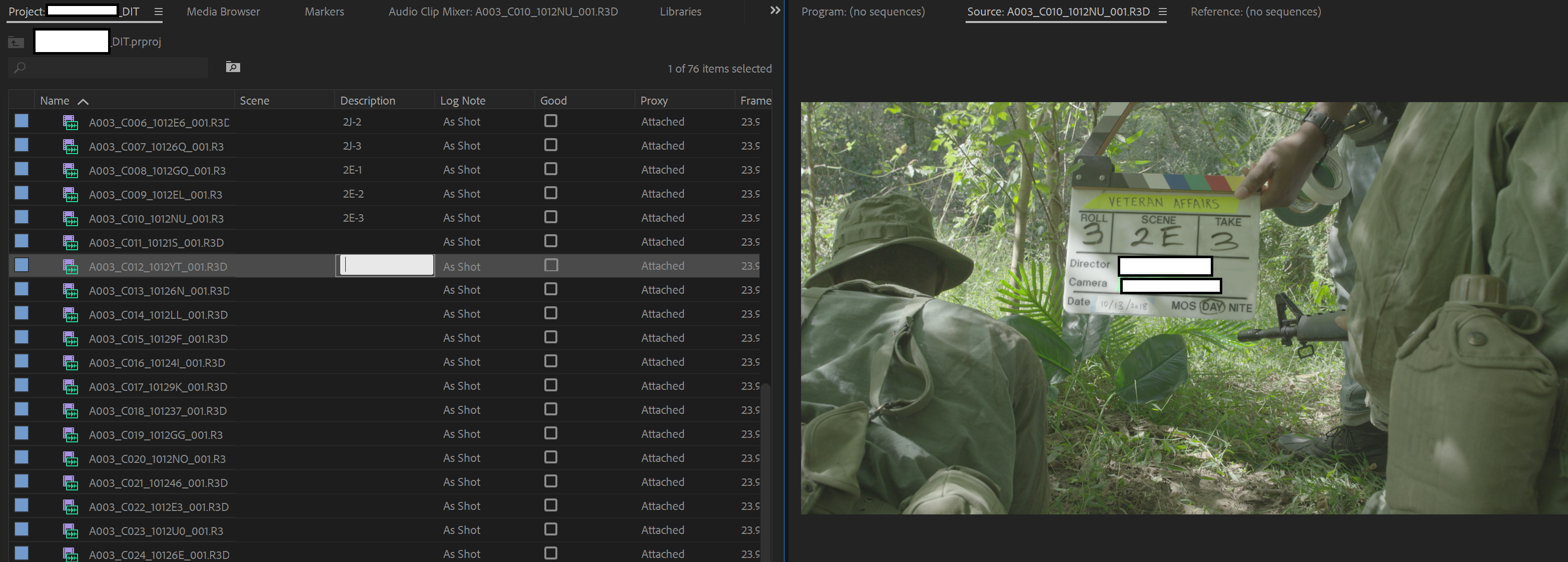

I do a LOT of media managing, and it is always a pain to have to double click every single clip every time I try to change metadata on my files.
On the project tab, I have all my clips. I press the "Description" tab, and it lets me edit it. If I double click the clip, it shows in the Source monitor.
My problem lies in having to double click every single clip just to change simple information on the metadata (like a slate on the first frame). Is there a way where when I press Enter, the next clip gets selected to edit metadata AND it shows up on the source monitor? That would save me a lot of headache when editing metadata quickly.
Below is an image as example. I already labeled 2E-3 and pressed enter to edit the data of another clip, but 2E-3 still shows on the source. If I double click the clip I'm trying to edit, then I get that video on the source monitor.
Is there an option? What about a shortcut that shows the highlighted clip on the source monitor? As long as I can stay on the keyboard and not have to switch between mouse and keyboard, it would really streamline my workflow.

Shift + O will open clip from Project window in Source Monitor.
Community Beginner ,
Oct 14, 2018 Oct 14, 2018
Awesome. My only issue is that if have the text open for editing the metadata, Shift+O doesn't act as a shortcut, but for capitalizing letter O.
LEGEND ,
If the text active, hit the Enter key (not the return key) prior to typing Shift+O
MtD
Yes, I tried it for you earlier, assigning it to an available key ctrl-alt-O (that way it works even in the description field) and I could do the whole thing with the keyboard, but it took a few keystrokes. From the metadata workspace, when you press the ctrl-alt-O it opens and selects the source monitor, so use the hotkey to go back to the project window, then tab a couple of times to get back in the description field. I didn't post this earlier cause there is a few keystrokes needed, but its all keyboard, no mouse.

There are a few things you could do to speed things up.
Ideally, you should use a macro app to record the specific keystrokes you make to open the clip, switch back to the Project panel, and then navigate to the Description field. This would be the fastest way for you to get things done. I've set up a quick demo of how this would work - I am using a single keyboard shortcut in the clip to open the clip and move to the next Description field. It took me about a minute to set up the macro:
https://1drv.ms/v/s!AhyOTAuOwz3Hl_5wLzVakJI4AgBWxw
Alternatively, you can load up to 50 clips at a time in the Source Monitor. You can then switch to the next/previous clip with a keyboard shortcut (you need to set this up, there isn't any assigned by default).
Also, you could duplicate your bin, and open the 2nd one up next to your list in Icon mode with large enough thumbnails for you to read the code. You can hover-scrub the thumbnails without even clicking on them.
