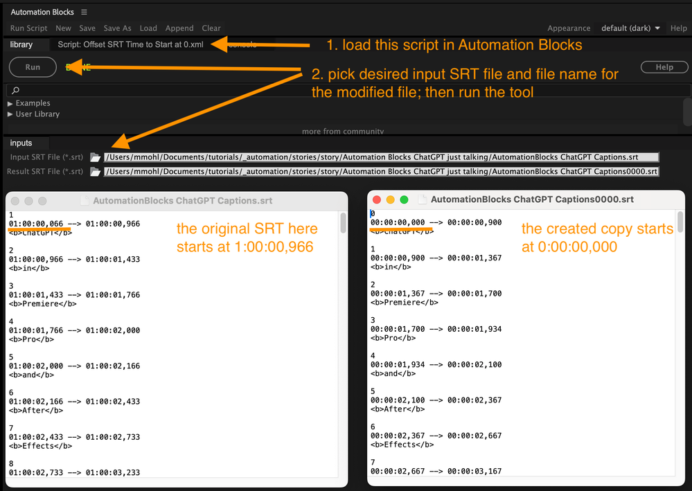

In the Automation Blocks tool mentioned above, you have to enter the time offset manually in the inputs panel.
If you want the time offset to always be exactly such that the first title text starts at 0, then you can use the following tool I just wrote for you:
File Handling/SRT/Offset SRT Time to Start at 0.xml
(also now in the Community Library)
It works very similar,  but this time, you just enter a input and output file and the offset is calculated automatically such that the SRT starts at 0:
Mathias Möhl - Developer of tools like BeatEdit and Automation Blocks for Premiere Pro and After Effects
