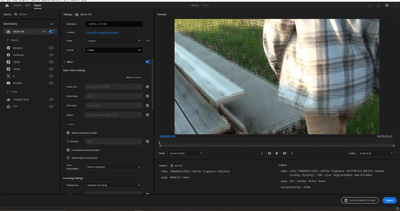

I looked at the preview screen of my export window for the crushed footage, and it looked EXACTLY how I wanted it to; the lines weren't too thin, but not too thick either. (below)

So then I got the idea of exporting my footage as a smaller resolution, so that the lines may become thicker and the effect will be less harsh. But for some reason, when I export it (say, at 1080p) and open it in preview, the interlaced lines almost look greyed out and not at full opacity, which tells me I'm doing something wrong with changing my resolution. (below)

To clear up any confusion, the "thick scanlines" that are in the preview box in the export screen are showing when the interlacing pattern (at full screen) is perfectly every other (even/odd) pixel. So when I fullscreen the video window in the sequence with my interlacing settings, the lines are very thin (which is what I don't want). However, when I go to the export screen to export my video, the preview box looks completely different from the view I just saw in the sequence video; the lines appear much thicker. I am more fond of this look than the one in the sequence, because the interlacing looks a lot more natural.
Additionally, I apologize if I've asked this question again and again, but do you know how Premiere constructs the preview box in the export screen? It looks perfect in the preview box, and I think it would be better for me to just recreate whatever settings it's previewed at (in the export window) within the sequence/export settings, instead of having to resort to venetian blinds.Screenshot 2024-05-17 224532.png

I think we're back to screen recording that window.
