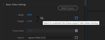

I looked over the questiona bit more;  Two things;   As Ann Bens pointed out there is aspect ratio issue, that is driven by the pixel aspect ration.   1.0 vs 1.33 if my math is correct;  I took a screen shot below so you can see what exporting at 4096x2160 does with your original frame size.
BUT; You can unlock the aspect ratio of the export if you want to force it to 4096x2160 exactly;  use this button on the export dialog;
And this is how your video would fit into a 4096x2160 frame when the proper 1.0 pixel aspect ratio is used compared the 1.333 of your original frame size.  Use the unlock aspect ratio button to get the desried frame size you were looking for.

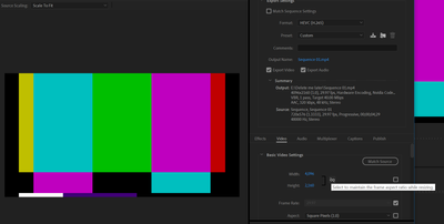

Apr 23, 2021 Apr 23, 2021
No at all need to convert the footage to square pixels. Premiere Pro takes automagically care of the pixel aspect ratio conversion.
In this example i placed 16:9 (1.333) footage on a 4096x2160 (1.0) timeline and upscaled it and all proportions are retained and not distorted when exporting. See the attached image.
