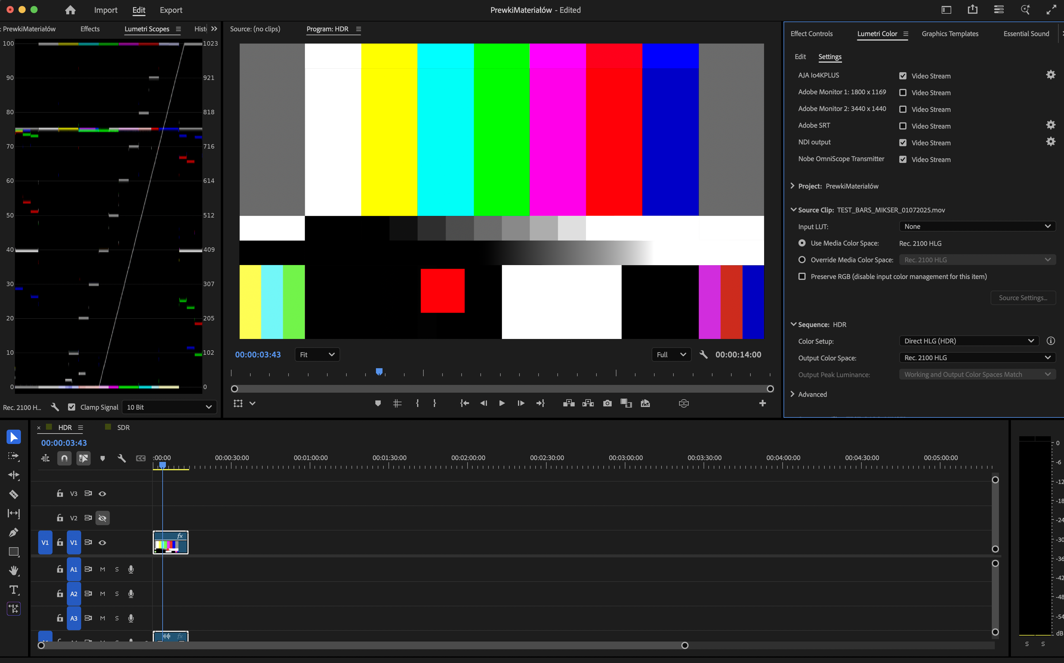

Please have a look at three screen shots. Lumetri Scopes for Rec709 (of course SDR clip on the timeline), Rec 2020 and Rec2100.
Rec2100 simply shows lack of full dynamic range.
Now - if you look at the fourth screen shot - showing test bars from the OB you can see full dynamic range in Lumetri Scopes in Rec 2100.
BUT - this dynamic looks overexposed on my Canon DP3120. See picture.
Lowering the exposure -1,2 makes the histogram correct on the monitor (picutre) BUT it is too low on the Lumetri Scopes in Premiere (getting to the range of Rec.2020)
So bit confused here..
How to up-mapp SDR footage to achive full scale in Rec.2100?
Rasing Exposure, Whites, Highlights of course makes the whites goes up but the whole picutre is getting too bright.. Am I missing something?
Thanks

Well - I've been working with HDR for few years now and have some understanding of requirements and limitations. I am, however, video engineer so I can setup HDR environment, monitor signals, control the conversions and .. validate footage I'm getting however when it comes to details with footage creation - especially graphics - like in this case - it is a different story and to my surprise I got confused checking clips I got.
In my opinion the major problem with HDR is that people think that conversion will do the magic and they prepare SDR versions only, converting them at the end and expecting great result. But that is no wonder as many of top production companies recommend such approach when it comes to graphics for live productions.
As I am NOT colorist and should only accept or not the clips I got, I don't have deeper knowledge of the process how they were created but my guessing was right and the company responsible for preparation admited they just up-mapp the SDR versions. When I showed them that in Rec.2100 white is at 75% (roughly) they said they have no idea what they should do with it.
Comming back to details you have mentioned: scopes were/are set to 10 bit, color space was HLG. You can see it on one of the pictures I've included. I'm not checking on my computer monitor of course - I use Canon DP3120 reference monitor.
I have twiked (if I can use such expression) highlights, shadows, whites and luma curve and achived satisfactory result.
BUT was couries to hear what workflow is recommended for HLG masters delivery. You say one should not grade with the HLG scale? It seems like grading without it makes the whole picutre/graphics too compressed and that is why in the Rec.2100 space there is a huge head room after transfer.. Am I wrong?

Grading with the scopes in HLG but using a 10 bit scale doesn't restrict the top values any more than using the HLG scale for the scopes does. That only affects the scale used to denote the specific points, not the range black to white. You are not grading in SDR when doing this. Your space is the HLG setting.
You do get a lot wider view of what you're doing in 10 bit scale rather than their current HDR scale. Because they insist that the thing is set up in essentially a log format. Look at the scopes in HDR scale ... remember, your top normal value will be 200 nits?
Where is 200 nits on the scopes when in HDR scale mode? Well below half, right? You are never going to have anything above 1,000 nits ... so the top of the scopes scale is completely wasted space.
You only use really the bottom third of the scope ... and so you cannot see details in what you're doing. Hence using the 10 bit scale.
Now, at this time in Premiere, "graphics" is a bit of a problem. They can oft be 'gray' in HDR or even SDR timelines. If you have an issue with a graphic showing grayish rather than white for white letters ... select the graphic clip on the timeline, then in the CM Settings, set the override-to option to HLG, or maybe the Arri wide log.
Does that help explain my suggestions a bit?
