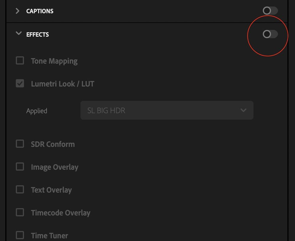

I'm not sure if this will cure the problem for everyone but I have just been suffereing this same problem. Without really knowing what I was doing, I thought I'd experiment. I tried turning off the effects button in the export settings and 'Presto!!!' my render, which previously took around an hour, now renders in about 30 seconds!!
Even when there are no effects selected, if the button is on it makes the render super slow almost as if it is trying to apply a 'non effect'. I hope this works for you guys.Screenshot 2023-11-15 at 15.16.34.jpg
Contributor ,
Nov 15, 2023 Nov 15, 2023
Well if that isn't a bug, i don't know what is.  But good to know as a workaround.  Thanks for the insight, @steveclarkefilms.
