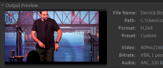

I'm running into an issue with the warp stabilizer where everything looks great until I go to render the footage via Encoder. My source monitor and my program monitor display the clip looking exactly as it needs to, but as soon as I export, the position of the clip has changed.
With the stabilizer, I am using stabilize only as the cropping and scaling doesn't work for my footage. Again though it all looks great until I go to batch export. I'm trying to do 7 different clips and I can't tell if the positioning is off until I've sent it to Encoder. It's not even showing up on the first export screen!

Here are two more screenshots - same session, different clip. Proxies off.
Copy link to clipboard
Copied
It's also worth noting that in the timeline project window, I've already adjusted the scale and position to fit the window. It's almost like the settings aren't mapping over during the queue process.

@RobotPirateMedia Could there be somethign wrong with Warp Stabilizer? I tried the settings (if I followed your note correct) and I get misaligned video in the preview right away.
If I want the video to end up in the center I have to turn on the Stabilize and Crop
I dont use the warp often, and seldom with the settings you indicated, however I was not expecting the clip to be mis-aligned like the first picture provided here (seems to match what your media encoder shows).
If I manual shift the image using the "motion" position, I can get it center (rough as its done by eye).
I dont know what is causing your issue, but to me it feels like a bug in the way warp stabilize handles the anchore point calculation when you choose the borders/framing to stabilize only. Every other mode I tried, the frame centers proper for me. What I see varies from you is that I see the effect right away, and you see it on export.
I will qualify this with, I dont recall what this same settings looked like before my work with them just now (I tend to use mocha for stabilize) so not as much experaince as you likly have with it, maybe you and can confirm if this expected. Either way, you not seeing it until exports is an issue, it should be what you see is what you get.

Thank you for your reply. One detail I left out is that the images I'm showing from my timeline is that is after adjusting my motion and scale to fit correctly. Before making that adjustment, it shows exactly how you've attached it above.
Also, something to note, it looks fine in the preview window when exporting within Premiere. It's not until it gets to Media Encoder that it seems the motion/scale adjusdtments I've made seem to be removed.
