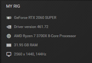

Thanks for the reply. I'm not that much of a tech-person but I will try to give you the info.
Here are pictures and info:

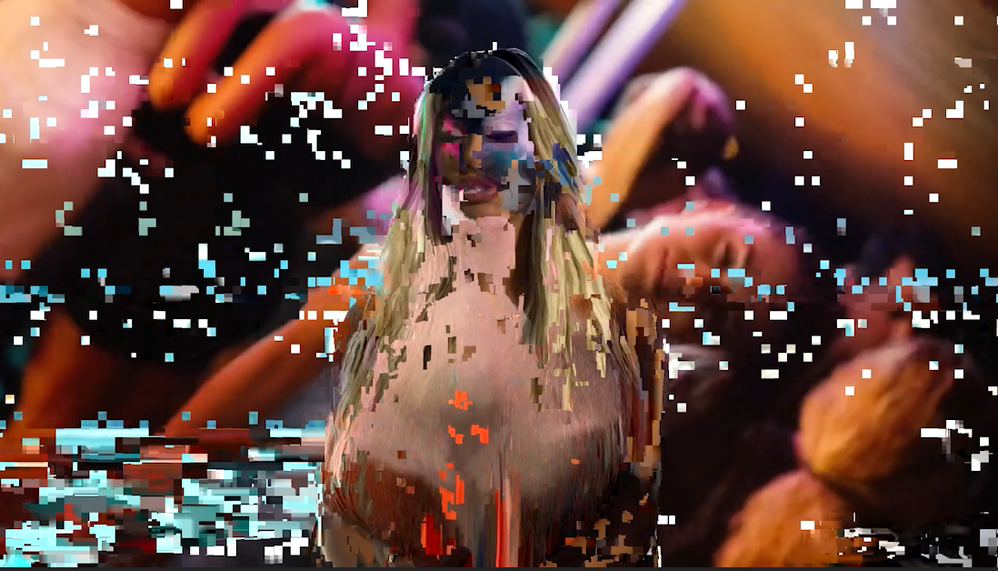

Very odd error considering that your computer seems to meet system requirements. The error, visually, indicates some kind of issue with your GPU. I would try a clean reinstallation of the NVIDIA Studio Drivers first.

Nice, that's more the information we need. Just some info on your drives, ssd's etc and also some info on your clips; Most of us use MediaInfo and post here a screenshot using TREE view.

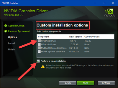

The new game and studio drivers are sporting the same version number and it is the same as you have installed. I'm not sure if the Studio version is therefore different from the Game version for this release, but you should probably try that first as Kevin was saying. Install the STUDIO version (from now on and going forward) and do a 'clean' install. There's a checkbox
There's a checkbox during the install 'Perform a clean installation' - check that (it erases the old version competely) and installs the new vesion. I only install the Graphics Driver (ever) I don't have Nvidia Experience or anything else from nvidia, if you can, do it that way.
Then try it like Kevin said and let us know if it helps or we need to keep trying things.

Thank you for your reply. I've installed the Studio Driver (Clean) But this didn't help at all unfortunately. 😞 Using Proxys doesn't help either. I use downloaded material from YouTube. (mp4 files) stupid glitch.png

Sorry for my unclear texts, English is not my mother tongue. Yes, the glitch errors also happen when I view them in the source panel. But it mostly happens randomly. Example: I've inserted a mp4 video from YouTube into the timeline, everything is fine but after a few minutes random glitch effects start appearing at certain frames.
And no, it only happens to videos that I download from YouTube. The downloaded videos work perfectly when viewing them with a VLC player or any other video player but when editing in Premiere, they start bugging out. I've also worked with videos that I've recorded myself (via webcam) (mp4) but they didn never bug out. Only Videos from YouTube so far.

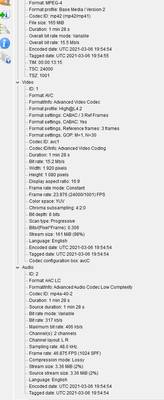

I've downloaded the program. In this screenshot you can see the info of one glitching out video.
Mar 17, 2021 Mar 17, 2021
you're doing pretty well if English is not your mother tongue.   We need more info from mediainfo.  Once you've dropped the clip into the media info window go to the view menu and choose tree and that's not available, choose text.    this attached screen shot should show what we're looking for.  take a screen shot of your results and post it back.  I'll do a new post with the transcoding processScreen Shot 2021-03-17 at 9.47.10 PM.png

Here is the screenshot!

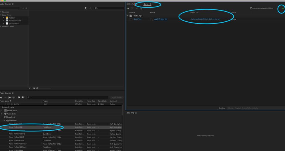

so it's constant frame rate.  so drag a clip into the queue window in Media Encoder.  drag the apple prores 422 quicktime preset from the preset browser:  broadcast:  apple prores: folder ontop of the clip you've dragged to the queue.  Then click on output file column which will allow you to set the destination and file name and then click the green arrow at the top left of the window.    Post back if any of this isn't clear.  Probably won't get back to you tonight.  It's almost bedtime in NYC for this old geezer.  And let us know if this solves your problem.Screen Shot 2021-03-17 at 10.01.18 PM.png
