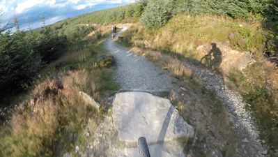

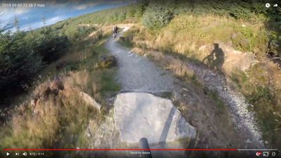

I've got Hero 5 as well, I'm happy with the quality until I upload the video to YouTube - I gave up last year, I've tried increasing the bitrate to 70 Mbps, I've tried 4K, 2K, 1080p, YouTube will always destroy my videos.
I've found your post, got really excited when you said the quality is great with Cineform 10 bit YUV Preset, I've tried it but it still doesn't help... I've even tried Cineform RGB 12-bit but still that doesn't help...
The picture below is before Cineform 10 bit YUV Preset before and after uploading to YouTube:
