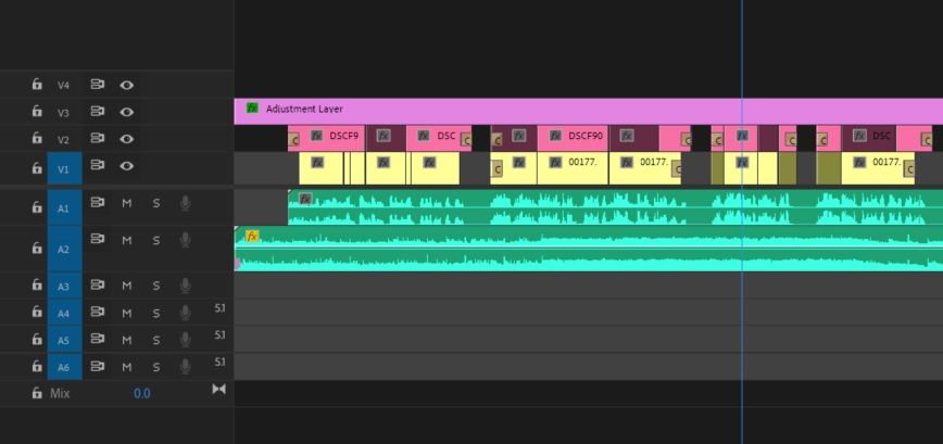

Plese see my attachment picture. I have multiple clips on my timeline. I have labelled it with rose color and yellow color.
I want to add an adjustment layer to rose labelled clips, and also add another adjustment layer for yellow labelled clips.
How to do this? Until now i can not find the best to add adjustment layer to these clips. thanks.

Copy the Lumetri from one of the adjustment layers ... simply click on the Lumetri tab in the Effects Control Panel, right-click, copy.
Select one color by right-clicking in the timline, Label/select label group. Right click on one of the selected clips, Ctrl/Cmd-V to paste. Should apply the Lumetri to all the labeled/selected clips.
I don't hardly ever use adjustment layers as it is very fast to copy/paste Lumetri from one clip to many.

but.... if you make changes to the adjustment layer, it get's applied to all the underlying clips. If you make adjustments to a lumetri effect on one clip, you have to remove the previous lumetri effect from other clips and the paste the updated lumetri effect. Unless there is a better way to do this. Always been a pain... But the OP's keeping each set of clips to it's own video track is a great way to work and does make applying and updating color correction easier...

Thinking about it, you could put the adjustment layer above v1 so at least you could change the color correction for all v1 quickly...

ALs are a bit of a pain ... as you can't set any track to only affect one other. So you could use your suggested process for one set of clips if you put all of X clips on V1, and the AL on V2, and other clips above that.
But you can't apply multiple ALs to different tracks. So yea, that's a pain.
Which is why copy/paste to "Source" clip tabs via pasting to clips in bins is normally better. It's still a fairly quick process to remove those and replace if you change something. Compared to other possible solutions.
Neil

I don't think there's any real solution to your problem but I seem to have found a 4 ways that are not so bad.
1. Stack Adjustment layers.
So start with your V2 clips, have an adjustment layer on top that and do your grade as a master adjustment.
So your base layer (V1), sandwhich another adjustment there and do another grade.
Of course, the adjustment layer for V2 clips will affect your base layer V1 clips, but you adjust your grade based on it. NOT IDEAL, but for a quick job not too bad.
2. Only use Adjustment layer grade on your base level V1 clip, the rest just do the old copy and paste of Lumetri.
3. This is I think the best solution. A bit hard to explain, so sorry in advance.
- Do your base grade on your V1 (yellow) clips with an adjustment layer on top.
- Your V2 Rose clips do another grade for that and put another adjustment layer on top of that.
- COPY the adjustment layer grade for V2 rose clips and stack it on top of that adjustment layer.
So you should have 2 idential adjustment layer grades for V2 rose clips one on top of the other.
- Select all your V2 rose clips and then use the move clip up shortcut (CMD + up arrow).
- With the V2 rose clips still selected move the clips back down (CMD + down arrow).
- Now do the same thing with the adjustment layer that you just poked holes all over.
Select all the clip segments of that adjustment layer and move them up. (CMD + up arrow).
After you've done that with the adjustment layer segments still selected. DELETE THEM.
- Now you'll have the adjustment layer only over the V2 Rose coloured clips.
- Now of course if you change the grade for V2 Rose, you'll have to repeat the process.
It's not ideal, but once you get used to it, it's pretty quick. Like literally 5 seconds.
4. Use "remove attributes" function.
- Grade your V1 Yellow clips and whack an adjustment layer on top of it as per usual.
- Grade one of your V2 Rose coloured clip and then paste that Lumetri effect on all the clips.
- Now if you want the change grade for V2 Rose clips, select all your V2 Rose clips, right click > Remove Attributes. Under effects, find Lumetri colour, tick it, then press ok. This will delete all the Lumetri effects from all the Rose coloured clips.
- Now grade a Rose clip again, then paste on all the rose clips.
- This method will take about 15 seconds so it's not as good as the other way, but still a good trick.
