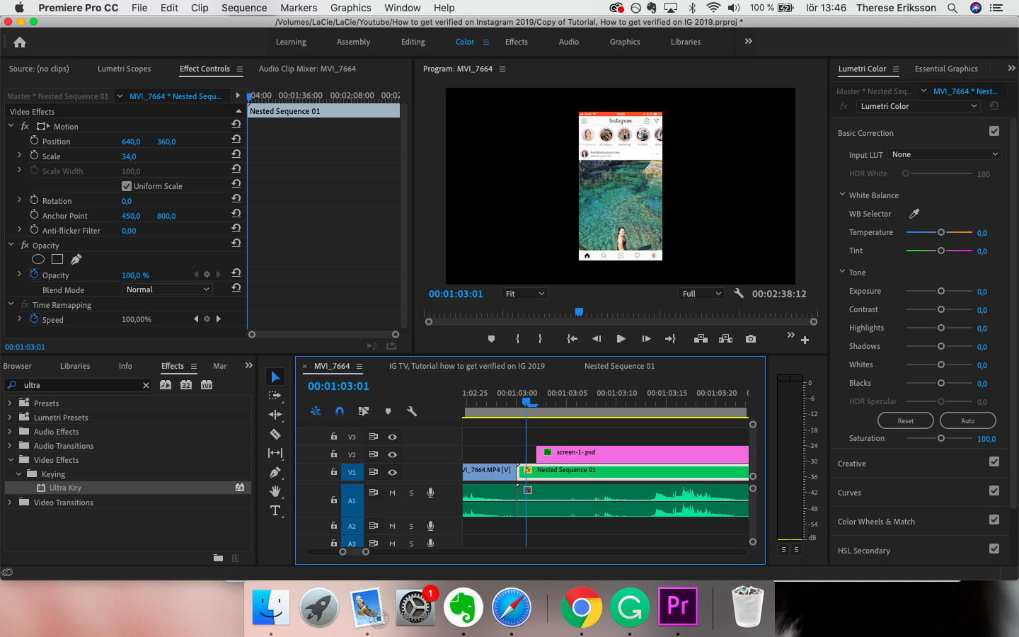

I haven't had any problems before with using Ultra Key for green screen, but I think after a update it started to act wierd.
So I have a project for example here:
This is how the colours should look like on the screen that I want to replace the green screen with.

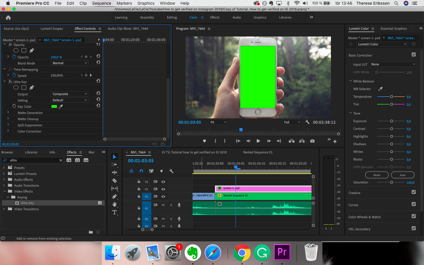

And this is how the green screen clip looks like:

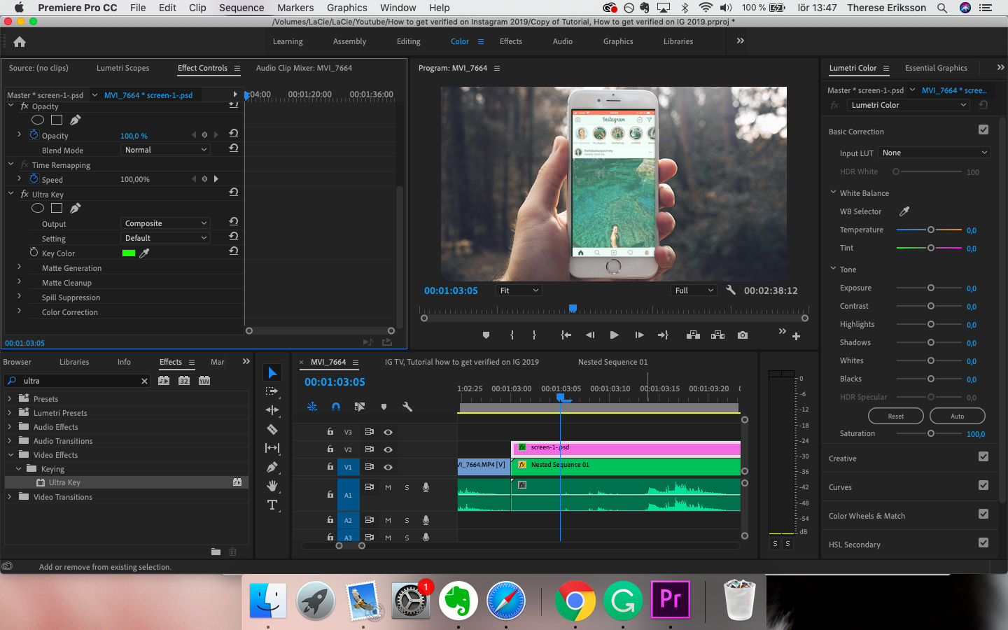

Adding ultra key and mark the green color, I get like a dark green filter over my clip that I replace my green screen with. WHY? I have never had this problem before.
If you compare the first screen shot with the last one you see the slightly color change of green that happened. I can't make it go away.
Any suggestions what have happened?
Sincerely Therese

What is inside the nested sequence.
If its a still why not use corner pin for the image.

You may have answered your own question, and discovered a bug in the update.  Ultra Key should work fine by sampling the vivid green in the PSD.
You may need to try a workaround as Ann suggested, or go into Ps and create a matte channel, or delete the green in the screen, or some other method that will make the green in the PSD now transparent when you see it in Pr, such as drawing a mask on the Opacity in the Effect Controls in Pr.

Hi!
Thank you for your reply!
I asked Adobe's support and they said I had wrong RAM for the 2019 update, so I worked around the problem and did what you suggested 😃 Thank you so much!
