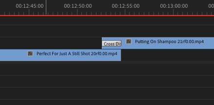

Dec 23, 2020 Dec 23, 2020
mrgrenadier described it pretty well in text, but here are a couple of pictures to illustrate what he said about "handles."
When you create a crossfade (or any other transition) between two clips, this is the actual amount of media that you're using from each one. You are just seeing it in the form of the transition bar.
If the clips do not have media that can be extended (handles) then you cannot apply the transition.
This is how you would add a "handle" to a clip that doesn't have one; by trimming media from the beginning or end of the clip. The amount that you remove is the amount that you can create a transition with:
instead of adding dissolves, checkerboard your timeline and add to both outgoing and incoming shots so the overlap equals the duration of your desired dissolve.   Hopefully the attached screengrabs will help you understand this...checkerboard.pngadd a dissolve to checkerboard.pngnormal dissolve.png
