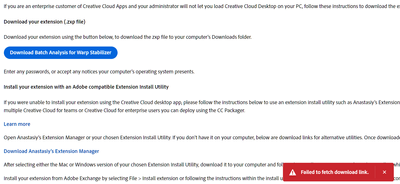

Oct 18, 2025 Oct 18, 2025
How do I download this extension? I'm getting this message.
LEGEND ,
Are you working in a company that has many CC licenses ?
