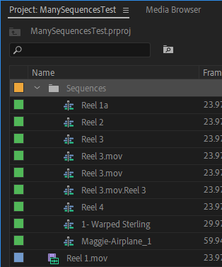

I just created a project and made 10 new sequences each with a clip and they all work fine. I closed each one to create a new sequence, or you could select each clip and right-click and 'new sequence from clip' so, not sure. I played each one, then I loaded all of them and played each one and all was well
On the positive side, you've doubled the # now as you had 3 - now it takes six to slow you down!
