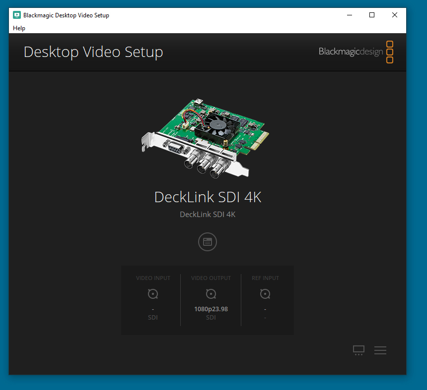

    When I open the Blackmagic video setup thing, I see THIS.

    You should be seeing an option via video desktop (under Blackmagic programs in 'programs' ) similar to what you see in pic above... but with your own specs for SDI output, etc.
    My video monitor is 1080, so that's what I use.
    Anyway, if you disable device, and REBOOT...THEN YOU CAN ENABLE DEVICE. Then reboot, and it should find the drivers it needs if you have then on your computer...or you can choose to look on internet.
